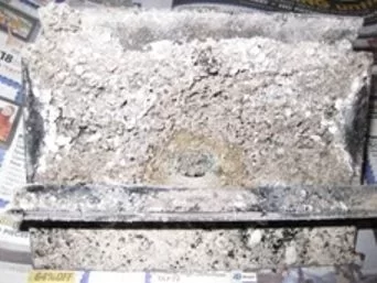

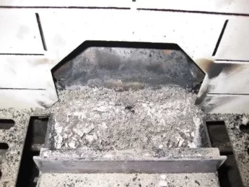

Happy new Year! I had some issues with m St. Croix Hastings stove when it was first installed since the ash clean out rod was not pushed in all the way. Since then, I have had some good burns, and now I am getting a full burn pot after running for about 3 hours. I have cleaned the stove many times and can't get the burn pot to stop filling up. I used a wire bursh on the burn pot and the piece underneath it to ensure nothing was caked on. The pellets I am using are Country Boy Oak pellets and I have been told they are one of the best so I have ruled out the quality of the pellets as a possble issue.

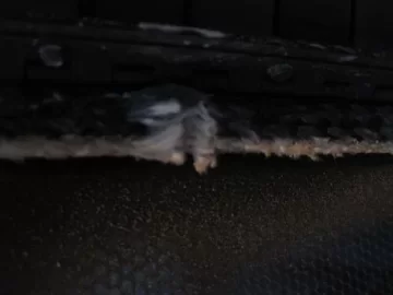

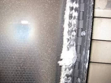

I also found that the seal on the door might not be good.....the rope seems to be coming apart. Please take a look at the pictures below. Any suggestions on how to get my stove to run properly would be greatly appreciated!
Thanks in advance!

Pull everthing out of the stove... cerabrick, burn pot, versa-grate, side grates and flappers above the ash pan.
Dump the ash pan and put it back in. Use a hammer to tap on the back wall of the INSIDE of the stove. I bet you'll find lots of ash falling into the ash pan... keep it up until you don't get anymore ash. Make sure you THROUGHLY clean out the area UNDER the versa-grate.... especially the area to the front of the stove... that is VERY easy to miss! Be certain both the burn pot rod and the heat exchanger cleaning rods are pushed in AND the ash pan is tightened.
Reassemble the stove, set the intake damper to be open the width of a pencil, put ten pellets (or so) in the fire pot. Start the stove on #3 and let it warm up before re-setting the temp.
If THAT works you simply have a stove that was plugged up with ash. You should use a strong shop vac or leaf blower to throughly clean your stove.

You can get the versa-grate out by allowing the stove to run with the door open...it moves back and forth on it's shaft and should move enough in a minute or two to allow you to pull it right out... took me awhile to figure that out.
When I first got my stove I'd restart it with a handfull of pellets... it always would overfill the burnpot. If I only use a few pellets it works must better.

All great advice so far. The only time I saw ash build-up anything like that I had a blockage somewhere in my exhaust chamber. Using a leafbower or strong shop vac to suck it all out should clear it.
On the other hand, if your stove is new this year (I seem to remember it is) you may want to try another brand of pellet. Just because someone recommended those to you doesn't mean they'll burn well for you. Furthermore, it is possible to get a bad batch/ton of a good pellet. Try a different brand of pellet is typically one of my first troubleshooting steps when I encounter a burn quality issue.
Let us know how it goes.
Mkmh, when I first had the stove installed the installer did not know that the ash pan clean out rod needed to be pushed in so it ran for quite some time with it open. I believe this caused black smoke to come out of the chimney and ash to buildup in the exhaust tubes. In the process of cleaning the stove yesterday I decided to vacuum out the exhaust tubes using some tubing taped to the hose of my shop vac. I also did as others suggested and used the tube to clean out under and in front of the versa grate and cleaned all of the heat exchange tubes on top. Well, all of these suggestions combined seem to have resolved the issue. I will know for sure tonight when I turn the stove off and check the ash pan. I'll post a message tonight to confirm.
Those stoves get plugged with ash behind the firebox... a good "suck job" with a leafblower or strong shop vac will do wonders... looks like you are on the right track.
