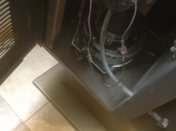

Here's a photo of the jumper I made to test our high limit switch. [Hearth.com] St. Croix Hastings won't stay on.

It sounds like the proof of fire switch, mounted on the exhaust blower housing, is not being satisfied within the programmed time limit. That's what causes the #3 light to blink. You can jumper it out to test the theory. It's visible in the above photo right at the center of the picture, on the blower housing behind the hanging connector.
If the stove then runs properly, you have a bad switch, assuming the blower housing has reached about 100 degrees F.
The overtemp switch will give you both #2 and #3 lights blinking, and must be reset manually. Plus, if it is tripped, the auger won't run.
Very easy to make the jumper. Just pull the 2 wires off the high limit switch. Take a heavier piece of wire, strip the ends off it and stick them in the female ends of the wires you pulled off the switch
You can see the switch ends on the far right of the photo
I'm a girl. If I can do it so can you
I will point out that the jumper is not meant to run your stove full time. Just to test. You don't want to bypass the safety of the high limit switch
You could also try to push in the button in the middle of the high limit switch. That it a reset. It didn't work or us. But you could try that
