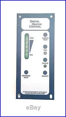

Got it burning tonight. Does not drop many pellets so cant get much heat out of it yet. Going to put a leaf blower on it tomorrow evening to be certain it is perfectly clear. Both fans work as well as auger motor. Seems the manual shows a different control panel than i have. Mine says nothing about trim settings on heat 1. Neat little stove. Think it will be nice once i learn it. It is in dads workshop so its not critical.
Tell us how many seconds auger feed light is on verses off for low verses high setting. Maybe it's not ramping up off low, especially if there isn't a jumper wire on red and black thermostat terminals (assuming you are not using a thermostat).
Low setting auger time might be 1.5 second on and 11 seconds off, high setting (#5) might be 5 seconds on and 11 seconds off.
A jumper on the control board can adjust these slightly to increase or decrease feed rates.
Can you show picture of which control panel you have?
I pulled this image from the web. The only difference in mine is it had a St. Croix logo at the top. I am going to check the jumpers tonight after work. Im only getting 1.5sec on time on any setting. PO may have had it on a stat and the stat jumper is missing keeping it on idle. Will check that first.

It sounds like you're right about the 'stat jumper. If your panel has a manual/'stat selector switch, make sure it's in the correct position.
Dad did a board reset and it took right off! Burning pretty good. Jumper was in place. I really like the clinker remover system. Can discard ashes without ever opening the door. Very cool. Gonna work out perfect for the shop. Thx for all the help.
