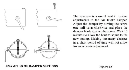

The damper doesn't need to be open by very much. I'm thinking a 5 o'clock position (or as others have said, place a #2 pencil in there and close the damper to that point and run it) would be more like it. But then I have a different model St. Croix than you do.

There is a fairly detailed explanation on how to setup the draft damper it would be advisable to do that at this time.
Procedure for adjusting the damper when burning Pellets:
When burning pellets in the Furnace, the adjustment to the damper will most likely need to be made
when the Furnace is running in the pilot mode.
a. If a heavy black shiny build (difficult to wipe off) up is noticed, on the glass and inner
surfaces, after the furnace runs on the low (pilot) setting for extended periods of time, the
damper must be closed some. This may require the Furnace to run in pilot mode for a while
to become noticeable. If this build up is noticed, close the damper 50% to start out with, and
place the setscrew against the damper blade. Use this as the starting point to make additional
adjustments with the setscrew. Some build up is normal and may be removed during the
maintenance schedule.
b. Once the adjustment has been made for the pilot setting slowly advance the Furnace to the #5
Heat Level and observe the flame. If black soot (wipes off easily) builds up on the glass and
black smoke is visible at the tips of the flames turn the setscrew one ½ turn counterclockwise
and bring the damper blade up against the screw. Wait 5 – 10 minutes before attempting
another adjustment. An occasional wisp of black smoke is normal every now and then.

Probably right, I'd start with a pencil width open to start, and go by the manual to adjust it, only a little bit at a time, be patient ........... looks like it should be under control now, good luck, keep us posted ......
Reactions: bogieb
That sounds like good advice as it seems a lot of st. croix users have their air dampers set at a pencils width with success. I have just had so many obstacles that i am hoping i am getting somewhere after all of this :) your help has been greatly appreciated. I am curios from another st croix furnace owner is how do you get the two ash traps (side of burnpot) cleaned? I use a dryer vent brush which seems like it extends up the entire area but i do not have a way to necessarily vacuum up there as i do not have any type of small flexible hose to reach, is that even necessary?

Glad you are on the right track with the end cap cleanout! If it is getting lazy on #4, then you may want to open just a tinge (not even 1/2 a turn). But if you run it mostly on 1-3, then maybe you don't want to touch it at all.
My manual states:
Once the damper is fine tuned for settings 1, 2, 3 and 4 the stove will run fine without having to make a change to the damper setting unless the stove is run on 5 or 6 for extended periods of time.
So, I wouldn't change it unless you use the #5 setting a lot (I don't even get close to the top setting in my small house).

bogieb - thank you for your reply... My stove has settings 1-5 and i typically run it on 3 or 4 myself. I do not have a large home only 1200 sq. feet but i do have very tall ceilings 14ft in all but bedrooms which are 10ft so i know i lose a lot of heat up there, i do run ceiling fans on reverse to try and bring that air back down. I would really like to get this unit to be able to run level 4 optimally if possible.. so i will very slightly open the damper a tick and see how it goes.. In the past i have always had the damper wide open as that is how I inherited it and the service pro that came out didnt make any changes so i assumed was correct and never really dinked with it. I am running "super premium pine" pellets right now and i am hoping that once i get it tuned that it will still burn the premium hard wood pellets well also as i have 3 tons of hardwood and 1 ton of the pine pellets on hand.. might try mixing them one bag of pine and one bag of hardwood to spread them out to.. not sure yet..

. . . . In the past i have always had the damper wide open as that is how I inherited it and the service pro that came out didnt make any changes so i assumed was correct and never really dinked with it. I am running "super premium pine" pellets right now and i am hoping that once i get it tuned that it will still burn the premium hard wood pellets well also as i have 3 tons of hardwood and 1 ton of the pine pellets on hand.. might try mixing them one bag of pine and one bag of hardwood to spread them out to.. not sure yet..
The manual states if you have a long horizontal run, then you will need more to open the damper. If I remember correctly, your horizontal run used to be quite long but you got it shortened up. If that is the case, you probably won't need as much air as it used to take.
