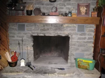

Here's the photos of my setup.
My fireplace with the old doors removed.

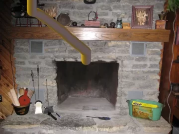

Here's a rough guesstimate of where the SS liner would need to be routed.

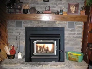

Here's my intention.

I don't think that's to terrible of a bend for flex.. I would drop something down your chimney to figure out how much length you need and then get that amount of flex with a kit.
