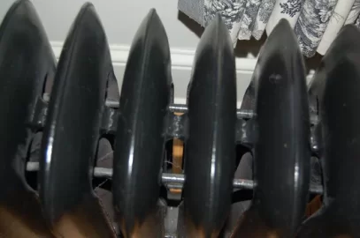

    Here's an old steam radiator without a top pipe. I figured out how to make it work well in my hot water system, but that wouldn't be a practical approach in your case. If yours look like this, in other words, then it's back to the drawing board.

    I just checked all of my radiators,they have 2 taps top and bottom and a small screw plug at the top of each.Also the tops of each are connected together so I am guessing that they should work?That would be great.I won't talk about the existing pipe covering but I am thinking about abandoning the old pipes and run new pipes,maybe Pex? Question is the way they were piped will leave me with feed in-feed out pipes in the cellar,can I manifold them in the cellar or do I need loops on the second floor.I don't mean to ramble but I also don't know how to pipe the radiators,feed in bottom return in top?thanks

    All my rads are piped bottom to bottom.
    If you're concerned about the plugs breaking the radiator casting when you try to extract them (steam rads tend to corrode while hot water rads usually don't), there are other, more labor intensive ways to get them out safely. Specifically, chemicals, heat, drilling--in that order. I've had a lot of luck with a drill, hacksaw blade and a cold chisel.
