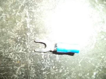

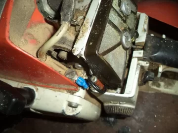

I've had this happen twice with my 028, actually just a week or two ago actually. In both instance for me, it was the ground for the switch that had broke. 2 minutes and a crimp-on spade and it was repaired.

[Hearth.com] Stihl 028 Super won't stop [Hearth.com] Stihl 028 Super won't stop
Wow. Looks like a cheapo crimp-on connector.
I'd use a ring connector instead of a fork. I'd also consider using the waterproof style that will melt its insulation onto the wire (instead of crimping), forming a very secure connection.
FYI, the IPL for that saw has a ring connector on that ground wire. PM me if you need a copy of the IPL.
I may have used a ring for all I can remember. Not really worried about it too much though, it's only a ground, and the last one lasted for the 15 years or so that I've had the saw. I was just trying to show how easy of a fix it could be. I'll see if I have enough posts to PM.......

I have an 028 AV woodboss. My saw had this same problem a few years back. There is a spring that closes the circuit when you push your switch all the way up (stop position). That spring wasn't making good contact with the switch. I carefully bent mine (bend and then check with the continuity meter). When you get nice consistent continuity between the switch and the ground screw shown in Joes169's pics, it is good to go. Your problem may be simpler (like Joes).
Mine was intermittent (sometimes it would cut off, sometimes it wouldn't). This solved my problem.
