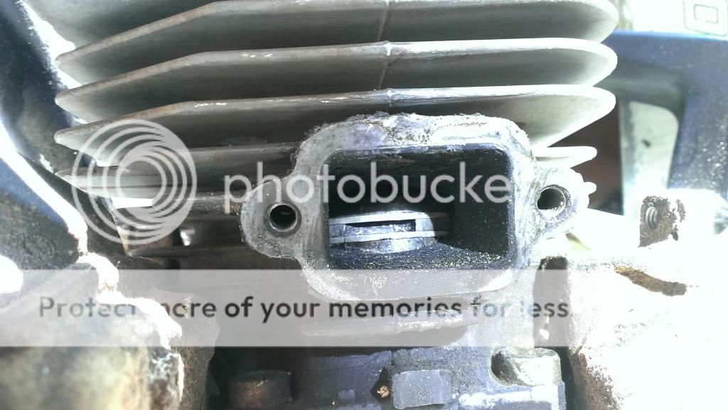

Thanks for the responses! I did pull the muffler off and took a peak. There is no scoring and the surfaces are smooth and shiny.It looks like new.
It won't hurt to do the carburetor overhaul so I'll start there. I'll also try the oil trick.
