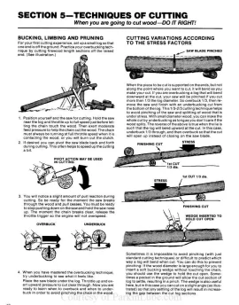

I'm sure some more qualified saw experts will give their opinions soon, but I have a couple of questions for you... Just so I have a better idea of what you were doing.
How big were the logs you were trying to cut? Were they flat on the ground, or was the something under one end? How deep in the log were you when the saw stalled? Are you sure the log wasn't pinching the bar?
You can check to see if the oiler is putting out oil by running your saw and holding the bar tip near a piece of cardboard. You should see some evidence of oil being flung off the bar tip.
[Hearth.com] Stihl 251 newbie chainsaw problems?
Overtensioned chain? Ask the shop guy for a tutorial. No shame in that, wish I did.
Good luck getting ahead in your stacks - hard but worth it!
