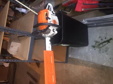

Just got this baby for free, it runs really good but the guy ran it out of bar oil and the chain doesn't turn. Does anyone know what parts need to be replaced so I can price them out ...
Thanks for your help[Hearth.com] Stihl MS 261 repair help
