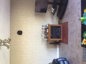

My house has a day light basement with the exterior wall built out of cinder block. The thimble location (hole in the cinder block wall into chimney) is located in this block wall.
Question is, the wall is only block with no combustibles in it. The second story is 2x6" construction which sits 20" above the thimble location and is obviously combustible material.
Is this wall considered combustible due to the second story ontop of it?

My mistake. I just measured the distance from ceiling to thimble hole and its 12". Does that change things?
