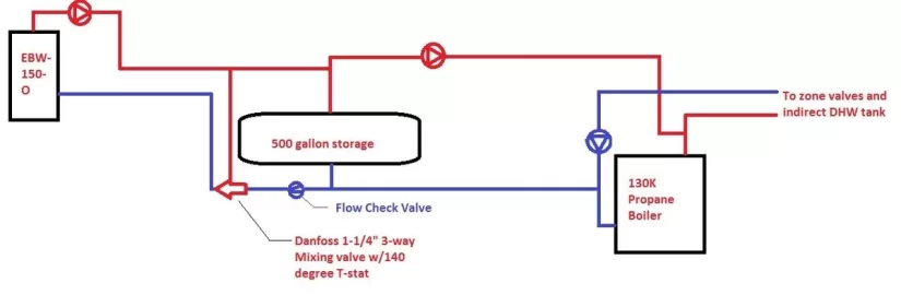

Last night I finished setting up my 500 Gallon storage tank and began charging it/opened it to the entire system.
My plumbing is simple:
Supply Side: Wood boiler supply 150' underground to in basement T, one end goes to top of storage tank, the other goes through a 3-speed circ to a T on supply side of my propane boiler.
Return Side: Return on propane boiler T to T on bottom of storage tank, one end goes to tank and the other goes through a Danfoss 3-way mixing valve to the return side of the wood boiler.
- 150' x 1" dia. underground pex each way (from house to wood boiler and back)
- indoor propane boiler has zone valves for upstairs, downstairs, indirect domestic hot water tank (just another zone with mixed output on the potable side) and radiant loop for bathroom
- indoor propane boiler has 1 Grundfos circ pump
- Econoburn Outdoor 150 set to 178 degrees F
I'm not sure if this is the most efficient way to plumb everything, and there are a few questions I'm having since putting the storage online last night:
1) How do I know if my circulators running too fast or too slow? My Econoburn 150 Outdoor model came with a 3-speed Grundfos, so that is set to the middle speed. The Circ on the storage tank is also set to the middle speed. The circulator on my propane boiler is a one-speed Grundfos, so I'll have to look into model to determine speed/flow.
2) The Econoburn Outdoor models are different than the indoor models in that they continuously run the circulator as long as there is power to the boiler. There is a Honeywell aquastat that is set to 190 degrees F on the supply side that shuts the fan off if the temp is 190 or higher. This morning the storage tank felt good and hot, however the indoor boiler showed a temp of 148 degrees F. The outdoor boiler was around 150 degrees F and the fan wasn't on (idling), however the firebox was more than half full of dry white oak splits.
- I'm thinking that the boiler fan should have been cranking and gasifying since my delta T was >20 degrees.
I think I need to set the Honeywell aquastat to something higher than 190 degrees F when running with storage, but does anyone out there have experience with the outdoor econoburn models and storage?
Matt

In the short run you should be able to get things to work. Think of your 500 gallon storage as a buffer tank. The 1" pipe could be a problem delivering heat. Given enough run time on boiler hopefully you can get tank charged even with the 1" pex.
Have you checked your head and flow rates with the circulator that is on the boiler since you are using the 1" pex ?
Your boiler shutting down ? Are you going into over temp shut down from not being able to pump away heat ?
schematics of your setup or pictures of all the plumbing would be most helpful, if everything was fine before you added the storage, I am thinking its a thermodynamic issue, compounding with a control issue.
Your pump head on the 300' of underground, 150' each way, not considering any other plumbing, is about 17', so actual probably is higher. Assuming you circ is a 15-58, your maximum flow likely is between 2-4 gpm, which also means your maximum btuh likely is 20-40,000 at delta-T=20. Depending on your heat load, I suspect there is little if any left over to charge the tank, except when the house is not demanding heat. One of the biggest mistakes people make on boiler installs is under-sizing the plumbing and/or the circulator. That's exactly the mistake I made in starting with 1" pipe, and an expensive mistake it was.
As to your 3-speed circ on the Econoburn, set it on Hi -- it may help a little, but not much.
Guys - thanks for the comments. My boiler schematic is below:
My boiler is not shutting down...that's part of the problem: once the wood is depleted, the fan continues to blast cold air into the firebox, effectively exchanging the heat out to the air. I'm looking into a simple way to solve this and may have it figured out, but I'll post more when I know more.
The boiler pump is on as long as there is power to the boiler - the circ never shuts down, so I have to think setting the speed as high as possible will be the best solution for now, regardless of head / flow.
