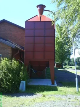

My sons school thats heats whit pellets and solar have this fine store
Hahaha. My neighbors would love to see that bin next door to them.
