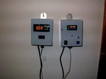

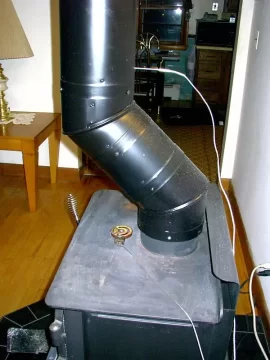

Apparently there is not an off the shelf stove temp alarm, so I built my own. Here is an earlier post with pics and a video about the stove alarm I built.
https://www.hearth.com/talk/threads/21198/
I have two monitor/alarms on my Regency, one for flue temp and one for stove top temp.
I also have one on the Fisher in the basement to measure flue temp.
I burn quite a bit of pallet wood, if you are not careful you can over fire. With the monitors/alarms
there is little chance the stove or flue getting too hot.
While the cost is considerably more than a simple magnetic thermometer (of questionable accuracy),
It is nice to be able to see from across the room just what temperature of the flue and stove top are, and not have to worry over firing. It is also great if you do something dumb like leave the door open too long when starting a fire. :red:

Where did you get that thermocouple probe? I bought one but it doesn't have metal shielded lead wires and it's only rated to 1295ºF. I'm afraid I might accidentally fry it if I just left it in the flue pipe. What temp range is yours rated for?
I think the TC you have will be fine. The one I have I think is only rated to 750 °F, haven't had any problems running it up to about 1000 °F .
The wire braid on the leads is nice to have but not a big deal if you don't have it.

Actually the one in the pic on the right is an Auberins unit. It works fine but needs more components than the unit on the left. To have an alarm you must add a peizo buzzer and a relay and push button ( so you can silence it). The unit on the left has a built in internal alarm. A power supply is not needed, as the units are powered by 120VAC.
