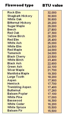

what type of wood is in the bundle? usually the stuff ive seen at Tractor Supply is a type of softwood like pine, pine will burn quicker and hotter than hardwood.
That cherry and oak wood may not be seasoned yet, depending on the conditions it was in, usually it takes 14 months minimum for most hardwoods and Oak is notoriously difficult to season, taking up to 2 or 3 full years to season completely. Wood also loses most of it's moisture during the hottest, driest summer days. I would recommend buying a $30~ moisture meter, you can get them from Amazon and maybe they have them at Tractor Supply too.
Burning cherry / oak wood is great though! each piece holds a large amount of heat, you only need 2 or 3 good pieces to get the stove nice and hot.
Here is a BTU chart of the different types of wood: btuchart.jpg
