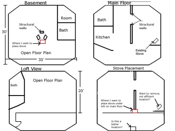

I am in need of help, I hope someone can assist me. I myself have no experience heating with wood, only as a young boy. I purchased a Geodesic Dome home it was build in 77 I believe. I am moving to this home first of November, I need to make a choice, and quick. There is an existing wood stove and a diesel monitor on the main level, not nearly large enough to do anything worth while. There is no Natural Gas at this location, so that is not a viable back up heating source. I will be using wood as the source to heat the whole home.
I have attached a picture I drew of the floor plan of the home, please take a look it will explain clearly what I am thinking, as my ramblings I’m sure are confusing, lol.
[Hearth.com] Stove, Location choice need help.
The Home has a basement, about 3/4 below ground. right around 1000 Sq. ft, it is 2 x 6 framing with a poly spray foam for insulation, and well done I will say sprayed the full depth of the 2 x 6. The basement interior was never completed so it is an open floor plan. The main floor is the same, has a few more windows but for the most part very open floor plan, and I can modify structural wall to fit my needs. Above that there is a loft a little under 3/4 of the 1000 sq. ft, it has a banister over looking the main floor.
The house has base board heat in the basement. This is far too expensive to run. My children’s rooms will be in the basement of the house so this area will be used, I will need a heat source down there. Do I have 2 stoves, one in basement and one on main floor?
The Main floor will need a larger stove than the existing for sure, I have a question as to will the stove that I choose for the main floor be able to heat the loft? Can I install an inline fan up higher on the flue pipe to pull some remaining heat out into the loft?

1. I need a Stove for my main floor, and best location for the stove?
2. Will this heat my loft as well, will the heat rise enough to not need another heat source for the loft or will I need a mini stove up there, can I install an inline fan in the flue of the main floor stove to supply heat to the loft?
3. I will need a heat source for the Basement also as it will be used as living space, best location?

Welcome Joshua. You are considering some good stoves. What make/model is the current stove? If a stove was located in the basement, how would the heat get to the first floor?
Howdy and welcome. I wouldn't count on the basement stove effectively heating much more than the basement. A stove on the main floor should have no trouble heating both the main floor and the lofted space. It will do nothing whatever for the basement. Where you've shown the basement stove is ideal, heat-wise, but I'm having a good deal of trouble imagining how you will arrange/install the flue from a stove there. Your two locations shown for a stove on the main floor are probably about equally effective heat-wise for main floor & loft. Here again, I'm wondering about flue configuration. Rick
Are you finishing the basement? Codes prohibit installation in sleeping rooms. Regardless, I would install an outside air kit. Six inches of sprayed foam is going to be pretty tight.
Chimney placement is a problem where you are considering putting the basement stove. Seems like putting it to the side, where you can enclose the pipe in a corner, or something like that, would make sense. Given the shape of the house, you shouldn't have trouble moving heat around.
If there is already a sound chimney in place, I wouldn't move the stove on the main level.
Realizing that everything in Alaska is expensive, shipping on a PH would be a killer.

Begreen - I didnt explain in the first post but I am unsure as to what the existing stove is, also it was removed by prevoius owner because it was not his to sell. As for getting heat from basement to main floor I am unsure, I just figured I would require a stove upstairs and downstairs? Seems a hassle but I dont know what else to do.
Rick - that's why I think I'm stuck with two stoves one on each level to heat both areas? As far as flue, can the placement of stoves I was thinking almost directly one above the other and run the flues side by side out the top?
I am very new to all this, so I have no ego lol,any ideas I'm open to (different configurations, etc)
The main reason I asked about the previous stove was to get a rough idea of the size the previous owner used. Dome are pretty heat efficient if built and insulated well. It's good that they paid attention to insulating the basement. That will help. If the heat can easily get from the basement to the first floor then one stove down there "might" work. But from what I'm seeing, that would not happen without a several grates in the first floor in addition to the flue chase.
As far as the main floor location, it might be fine, especially if there is a ceiling fan to assist air circulation. Don't worry about heating the loft. If anything, they tend to overheat, especially if the hot air stratifies without a fan to circulate it. One thing not clear in the loft diagram is what area is open to down below and what is not? Is it the bottom part of the Loft View?

If by chimney you mean brick? I am not sure of the terms Chimney vs. pipe? There is stove pipe from the existing location out the roof. Is it a good stack, I cant say till I get good look at it, the previous owners really were a "get it to work" type rather than "do it right" type.
From what I was reading, yes I had planned on using external air for the stove, this is better anyway right?
The loft view, the larger section of area where bath is on the left is the loft, the smaller area in the picture on the bottom is the main floor.
I have called WoodStock about the Progress hybrid, they have a couple deals going right now, I believe i can get it to my door for about 3500.00. I really like the idea of the soap stone creating mass. Should I buy a TuliKivi I was quoted 12,000.00 for a 1000 sq. ft model installed, still need structural changes so it will probably be about 14,000 installed, then place a smaller stove in the basement and call it a day? I could get the Tulikivi but it will break me, be eating mac and cheese for a while lol.
In the basement I intended to build rooms around the outer edge of the dome 2 of them and then leave a good sized area just open play area the stove will be in the open area. I am a bit out of the city and code is not a regulatory authority. That being said i do not take lightly the safety issue. There are egress windows in the basement, albeit not to code they are too small but an adult can fit through, this is one of the things I plan to change, larger windows and install a door in the basement.
I had planned to install a wood drop door through the side of the house, to drop wood into the basement from outside.
The Hot water heater is electric (I know, not happy lol). My plan was to install a Propane on demand hot water heater, any ideas?

If you got the wood furnace there would be no need for a main floor stove unless you just wanted it for ambiance and backup. Circulating heat downward is rarely very successful. Hot air wants to rise.
If you are going for the PH, you would be better off getting a smaller cat stove for the basement like the Keystone and running a pair of flues. The challenge is going to be chasing the basement flue up through the first floor. This should have some thought and planning so that is looks intentional, but is safe and functional. Perhaps a central hearth with a stone veneer finish? How will this weight be supported? That may require extending this theme underneath in the basement.
Just a thought, probably not code compliant........Progressive Hybrid in the basement location shown. Chimney chase starting from the basement ceiling, running up to the loft ceiling. Chase open around basement ceiling with hot air drawn up through the chase, by fans located in the chase-on the first floor level. Fans could even be thermosaticlly controled. Pics always help.
I contacted WoodStock, waiting on some answers. I can easily build structural support where ever I place the stove. I like your idea Begreen of making some eye candy of the structural support, I think I will proceed in the fashion. I have placed an order for the PH, I will be moving in November 1st. I will get stove installed and testing how it heats the home, depending on how it works I have thought of a few options for the basement, a wall mount monitor (oil, diesel, propane which ever fuel source is more economical) or a smaller wood stove we will see. At this point its a wait and see until I get in and install the stove. I will consult a heating contractor for the Flue since I have no idea, it is beyond my knowledge and I want it done right. I appreciate everyones help and I will be back with updates, pictures of the install and more questions lol.
