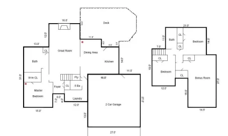

[Hearth.com] Stove location help So based on my research and other post, I cannot get an insert that will fit the prefab fireplace in the living room and there is no good spot for a free standing stove in there either. I know ripping out the old prefab fireplace could be an option but this would be too expensive. So our next option would be to install a free standing pellet stove either in the master bedroom or in the dining room. If we did this would heat be able to transfer to the rest of the downstairs? See floor plan. Red dots are proposed locations for free standing stove. Downstairs sf~ 1700 and overall sf ~2400

looking at your plans and imagining it were my house, the dining room looks like a great place.
the noise is away from the great room. but a small fan on the floor pointing into the stove room is going to displace the hot air right back out that door and into the great room.
the fact that the dining room/kitchen is a cul-de-sac air wise, gives the warm air no other option if it's being displaced.
even a small fan like a vornado or honeywell on the floor on the lowest setting will work a treat and be quiet too.
with those, you could even locate it offset to the doorway if you want the passage 100% unobstructed.

but again, to me, your dining room looks like a great location.

Looking at your lay-out, what is in the corner with the 4' wall next to the door? That would be a better position for a free-standing - air flow towards great room and heat will rise up the stairwell. Is it an open stairwell? Pics might help to figure out positioning in relation to windows...

That's a huge garage. Love it.
You'd probably have better success heating the place if you put the stove in the great room, on the outside wall near the bathroom. Make sense? Easier to get heat upstairs, and into the master suite. Bedroom is out. If you put it in the dining room, your master bath will be freezing. Too many doorways to get through.
