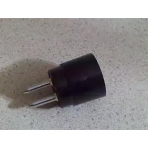

The cadmium solenoid usually never fails, replace the eye itself. You should measure about 5v through the eye itself.

UV light is not passing through the amber glass because the glass is etched from the years of heat.
Get the correct socket size for those nuts and take that puppy out.
It is either well crudded up or it is etched you'll know once you can get to it to clean it. I'd hedge my bets by getting a new filter. The flashlight has verified the photo eye as being good.
