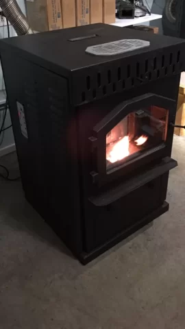

I put German Engineered High Temp Mirror Glass in my smaller Magnum Baby Countryside so I now have a “Mirror Baby” How does it look?

Hey don. Don’t forget to get your screw gun out of there before you fire that puppy up
LOL - It is on the floor! The mirror glass looks good?
Looks good don. I have it in the xxv But not in the advance. I like it but my wife not so much
