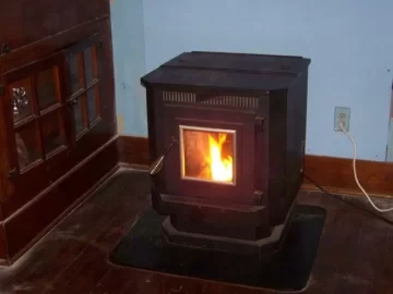

I'm thinking too much ash. I don't know another brand of pellets close enough to buy to try a different brand. Had a fire this morning after a vacuum again and burned oh prob 3/4 of a hopper full. End of fire I had a pretty good size mound of ash and some unburned pellets at the end of the fire but not a whole lot. The rather large mound of ash is what concerns me. I'll try to get a pic next fire out to see if it an unusual amount of ash or normal. Of course I only thought of that after I just cleaned it again. The fire is a good sized during the rest of the burn. I don't know how to find the settings other than what I have it set on for heat which was 3 and 3. I have a pic of the fire. I'll try to figure out how to post pics here.

Here is a pic of the flame. Excuse the dust and things please, it is a project rehab house.

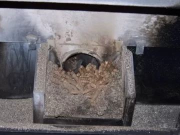

Ok this is what I am left with in the burn pot after burning about half a hopper full of pellets. This had been vacuumed before start up.

Just a ton of ash in there! I've have never seen ash like that in my stove, evah.
I have found that when I have had pellets left over like that on My quadra Fire, the feed rate was too high.
As the stove cycles on and off, the remaining pellets in the burn pot need to be burned completely before the next fire cycle begins.
Try lowering your feed rate if it is adjustable.
I do a clean & vac every Saturday whether or not it needs it. The stove I mean.
I have to vac it out after every burn and no way it's going to burn a hopper full going like this. Just wrong.
Wow that is a lot of ash especially after only one bag. I have never had that much ash build up even after 2 weeks of burning pellets and not vacuming.
What model Quad do you have, mine never has left over pellets, just a bigger fire.
