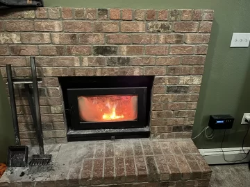

![[Hearth.com] stovepi -- Thermocouple Monitor and Blower/Circulation Fan Control [Hearth.com] stovepi -- Thermocouple Monitor and Blower/Circulation Fan Control](https://www.hearth.com/talk/data/attachments/341/341132-ebaa8d563d77d2a3f52944563f7745c0.jpg?hash=etQsT6nnIG)
The black box contains the bulk of the electronics, the wire runs to a thermocouple on the top of the fireplace insert, and the switches on the wall are for the built-in blower fans and two separate circulation fans move hot air to other parts of the house.

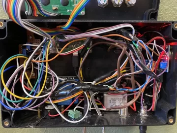

![[Hearth.com] stovepi -- Thermocouple Monitor and Blower/Circulation Fan Control [Hearth.com] stovepi -- Thermocouple Monitor and Blower/Circulation Fan Control](https://www.hearth.com/talk/data/attachments/341/341134-ad33a6ce1f416754e44bfa7425200827.jpg?hash=PP7BBgXxFJ)
The blower fan is normally powered through a fan control wall switch to lower the speed. The Raspberry Pi/Arduino uses low voltage to switch relays that switch 12V DC which is suitable for RB30 relays to switch 120V AC. A secondary relay provides power to the blower fans directly (without the reduced speed of the fan control switch) when the stove temperature is very high and the full speed blower is desired. Hence, the control system cycles the blower fan between three levels (off, low speed, full speed) depending on the temperature of the stove as reported by the thermocouple. The system is meticulously configured so that in the case of an error, failure, or default, the blower fan is turned on. Edge cases such as Raspberry Pi crashes and a toddler switching off the fan control switch have been tested.

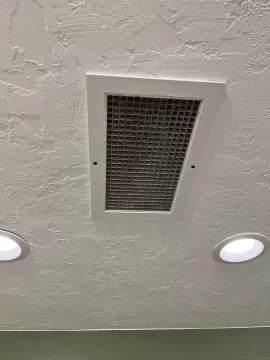

Circulation fans take hot air from the ceiling of the room with the stove and duct this air to other parts of the house.

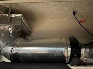

![[Hearth.com] stovepi -- Thermocouple Monitor and Blower/Circulation Fan Control [Hearth.com] stovepi -- Thermocouple Monitor and Blower/Circulation Fan Control](https://www.hearth.com/talk/data/attachments/341/341156-694b61db6d912232ddb89cae73b33917.jpg?hash=JBXmo1aVQB)
These fans support precise control (PWM) and are driven as a function of the stove temperature--ranging from about 10% to 50%. The ducts include multiple corners/offset and a filter so that sounds is not transmitted through them. The ducted air creates a loop of circulation that returns to the room with the stove.
