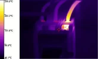

I just had a company do a Thermographic survey of all our major electrical components using a thermal imaging camera. We use this procedure to find electrical issues before they end in disaster. The hot wire has a bad connection and was repaired.
Neat! What repair was made here?
I did a thermal test when we moved into the house. Turned everything on for an hour, then went to the panel and felt each breaker. A few were definitely hot. The solution, tighten the screws. Several of the breaker wire screws were barely tightened.
Cool! I mean, hot! I will try that with my IR thermo....

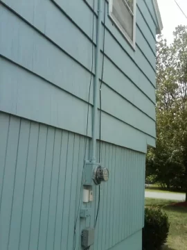

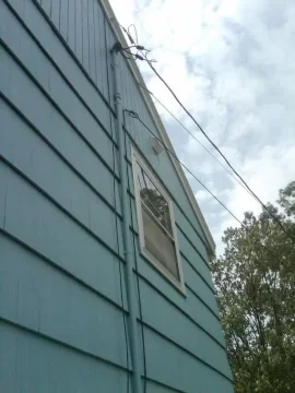

sorry for the delay in comeback. i've been busy. it's crazy around here. don show a picture of the pipe. or the from above the meter to the connections to the wire from your house and street wire. looks like water got in there and and got high enough to start going into the pipe that leads to the panel. your wires are copper with a lead coating. what would have prevented the water on the breakers is where the wires come in from the meter should have come in to the panel then to the side where they connect to the breaker, and before connecting to the breaker they should have come down to the side a little below the breaker and then bent up to go into the breaker. that would have given you a drip loop. once the water go's into the pipe with the wires in it, it follows the wire like a pipe and drips from the lowest point of the wire. have you looked at some of the other breakers for water stains? if you are going for a service change from 100 to 200 amp (which would be a good idea from what you said about how much you a drawing for a load) that would be a good idea. siemans or the square d would be a good choice. square d breaker cost more. going for the the service change is more that just a panel and wire change. the pipe on the house, the wire in it, the panel, the ground wire, the water pipe bond and a ground rod or two will have to be changed or installed. if you stay with your current setup drill a hole in the bottom of the meter socket towards the back about 1/4 inch hole for water drainage and install a new set of wires from the meter to the main breaker with a drip loop so that if any water comes in it will drip to the bottom of the panel and not hit any of the breakers and you should be ok.
frank
frank
Here are the pics of the metal conduit pipe. The transformer on the pole is new this past year and the wires from the street are also new Tri-Plex 200 amp wires.

looking at your setup i don't see where the water would be coming in but you'll be surprised what a beating the meter socket will take. if your ok with your setup just drill that hole, change that breaker to what should be in that box and you should be ok.
one other thought. the water could be getting in from the weatherhead. that's at the top of the pipe where the wires come out. if so, the water will follow the neutral wire right thru the meter socket and to the breakers. replace the wire from the panel to the meter and let the neutral wire loop down to the bottom of the meter socket before it goes into the pipe to your panel and you should be all set.
Not that it might be relevant since it's the opposite direction, but I noticed some water coming into the house in the winter via the outside conduit, and I think it was because of the cold air coming in. I put some of that clay-like duct seal in there and it didn't happen again.
[The power company doesn't want people messing with the meter socket due to the obvious safety concerns. However, a very common reason for them to encourage it is if you have a power outage and run a backup generator. Removing the meter is a positive disconnect.[/quote]
Great Idea! I have some non harding Monkey Dung. That would work great!!!
http://monkeydung.com/
  • [Hearth.com] Strange smell in basement and Circuit Panel feels hot next to 100 Amp Main Circuit Breakers! We have
Thanks again Frank
I really appreciate your thorough and honest analysis!!
i think that happens up here in mass. when we get real cold it usually is windy also. code states that when going thru walls or the like the pipe should be duct sealed or some how insulated so that no air is exchanged for that reason of condensation. all it takes is one time things get wet and the code book states that if a breaker gets wet, it's time for a change
I know I am late to the conversation but we run 25 kw generators for power supply
and one way of connecting them is to pull the meter and the end of the pigtail of the generator has a plug/recepticale
that connects directly to the meter base.[/quote]
yep some power company's don't like even us electricians in that meter unless we notify them first. and if they find a meter seal broken twice they put on a lock so that it can't be pulled unless they are called in.
btw, that's how i hookup my generator. then i put in the meter blank and it's sealed from weather.
Don2222 said:
Thanks again Frank
your welcome don. anytime i can help. if you find somthing on that leak let us know. i've seen leaks happen the next day after the rain stopped.
fbelec said:
So you're saying that the condensation occurs as warm humid air from the house leaks into the cold meter box? That makes sense but I just wanted to clarify.

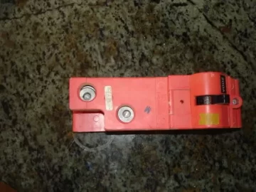

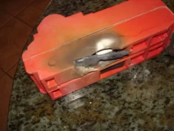

Hello
Check this Failed Breaker on YouTube Video!
Good Breaker contact shown by green arrow
Bad Breaker Contact shown by red arrow below!!
