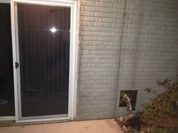

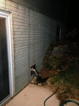

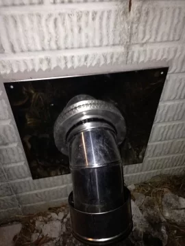

Here are the photos of our straight out vent install. (yes we still have to kill the grass around it) [Hearth.com] Strong smoke smell filling the room - bad install?[Hearth.com] Strong smoke smell filling the room - bad install?[Hearth.com] Strong smoke smell filling the room - bad install?

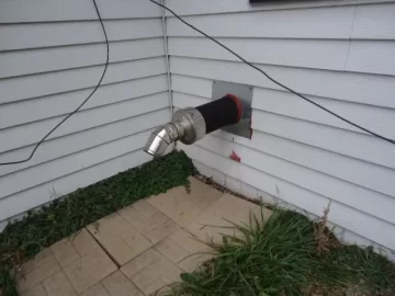

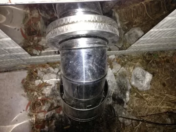

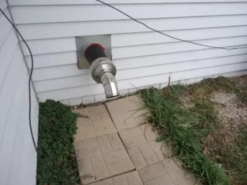

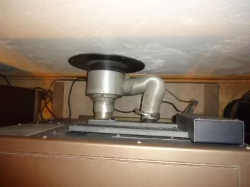

Here's the pictures that you asked for.

The only smoke smell should be outside the house and it is possible that areas around windows and doors are not sealed and the smell can come in that way, that is another reason I wanted to see the outside.
You need to check the sealing for that patio door, sliding doors are hard to keep sealed and that one is just close enough to allow enough of the smell (and a bit of smoke) to find its way in if the seals aren't working.
I can't see the underneath portion of that thimble on the outside to see if it is sealed to the house.
If that was a straight out jet cap end I think you'd just clear the ground to vent distance, but you need to measure it to be certain.
As Eric said it is a sloppy vent installation and while stove adapters cause problems for some installers a regular pipe usually is trouble for more folks than it is worth reducing the installation expense.
I double checked and the thimble is sealed on all four sides the same.
I need to check the door seal and also use a flashlight to check the vent pipe inside for leaks.

I have that same termination cap. The connection for it, is inside the thimble, another NO NO.
The installer needs to come back and fix this. Show them that the venting does not meet clearance to combustibles!! Something that an installer should be fully aware of. How dare this person endanger your life.
I'm sorry. But I would be RAMPANT!! Vent needs raised, extended out more (no joints on the inside of thimble) and the stove adapter needs High Temp Silicone applied around the collar.

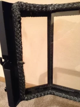

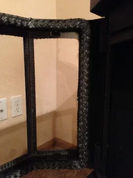

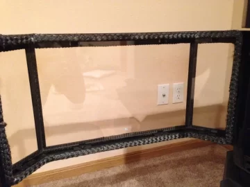

I did some more investigating and inspecting the stove last night. I'm wondering about the rope gasket. Most of the pictures I've seen show them to be a lighter color but mine is darker - almost like it has been stained. Is that normal? There's some tape on the ends of the rope where the two ends meet together that is coming off but no other snags or tears that I can see.
So I used a dollar bill to check for a tight seal. All four corners on the sides of the glass sealed perfect but the top and bottom center of the glass did not. I could easily remove the dollar bill with no resistance at all. Could this also be causing the smell I am having? If so, would replacing the gasket help? I can't see a way to really adjust the door...

I would not worry about the gasket color, diameter is the key.
I would replace it...especially while the stove is down....cause you are NOT using it right?????

While under some conditions it is possible for smoke to exit there I wouldn't expect that to be what you'd notice, if the door gasket is out of adjustment the usual symptom is a bad burn.
If you place the bill in there at the top center and press against the door near the door latch does the bill present resistance, if so I'd look for a means to tighten the latch, it isn't uncommon to have things work loose in shipping. You want to add that to the list for the installers.
That gasket you have has graphite in the material it is made of and that is why it is a different color and it makes no difference as far as functioning goes.
