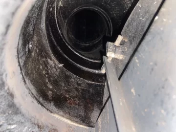

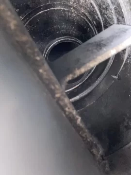

I swept my chimney is this clean? I did do a couple burns since then.
[Hearth.com] Swept Chimney How Clean Is Clean? [Hearth.com] Swept Chimney How Clean Is Clean?
The part shown in the photo is clean. Do you have anyway to see the upper part?
I don’t have a picture up top. I cleaned it from the bottom up. I was just concerned that I still saw some shiny stuff and was worried if there’s still creosote. Not sure how clean is clean. I only got about a cup worth of junk out when I brushed it out.
That's good.
