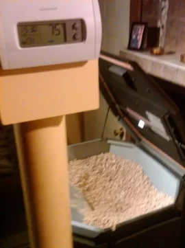

I am using a Honeywell 5-2 Programmable Thermastat but just as a Timer to come on at 3 AM and Off at 10 AM with the heat setting on the lowest setting # 1. See Pic below.
Please explain how you use your skytech in the shoulder seasons and exactly how the Swing Temp works. Also what heat setting do you use? Does the stove cycle On-Off alot?
