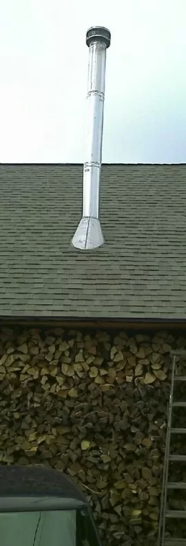

This one? The roof is just shy of 12/12.
  • [Hearth.com] Tall Metal Chimney Pic?
No, that's not the one I saw but thank you very much for posting it anyway.
How tall is the exposed part of the chimney? No braces?
I figure I'm going to have about 13' exposed which will need 2 braces. My roof is 12/12, a killer for chimney installation, at least near the lower edges.

12' above the roof penetration...just did guy wires as it will be moved to go through the ridge in the spring/summer. 12/12 isn't so bad, by the time I was done shingling I got used to walking on it.

I'd also like to see proper brace placement - I think mine could be moved higher. I have 2 - 36inch sections above the shingles, with the brace on the first few inches of the upper piece.
Should the brace be as near the top as possible?

Cudos-That just may be the picture I was looking for. That's probably about what my chimney will look like. I wanted a chase around it but my framer didn't think a chase that tall would hold up well to the wind and I tend to agree. I figure I will have a little over three 4 ft. sections of pipe exposed. According to my chimney instructions, I will need 2 braces on my chimney, one every 5 ft. Thanks for posting!! Do you have any more pics of your installation??

I was bing a little facetious, use roof jacks liberally. Not sure I'd call it walk, but you can move around on dry fresh asphalt shingles. Getting the chimney up was a bit of a challenge. We went one section at a time from inside the attic and lifted. Then dropped it down onto section that comes through the floor. It is a little unnerving to have that much money up there swinging around but it worked. Maybe pointing out the obvious, but if you use this method it is easier to put the cap and flashing on as you go than at the end.
