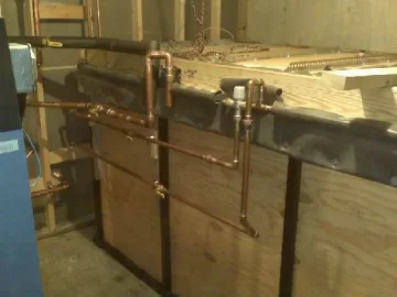

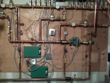

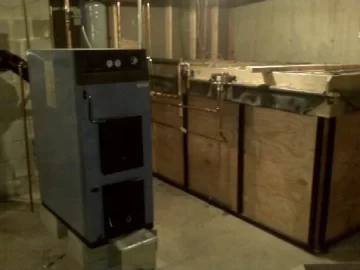

After 13 months, I finally got my Tarm and storage tank online. Using many peoples input from this board and others, I created a simple design that only uses four pumps total. One for the Tarm, one for the radiant floor section, one for the backup propane boiler and one for a boiler mate.
I do not have the backup boiler tied in yet but have it valved so that will be to do. But I'm getting my heat and hot water from the system. My wife was starting to lose faith that I'd ever get it burning wood. But now that the house is warm (especially the master bathroom) from wood there is peace in the family.
Most of the controls are off-the-shelf parts. I used a TACO ZVC-406 and switched from circs on each zone to zone valves and a TACO 008 pump to drive the loops. I am re-using my Taco 007s for the furnaces and DHW (backup from propane furnace).
The tank has a 1.5" square tube steel frame with 3/4" plywood and the 4" of insulation. I have a tie-in at the bottom of the tank but none at the top. The tank has spread about 1.25" at the top so I will have to fix that as it has ruined the seal at the top.
I'm now in the tuning/learning phase and am looking forward to winter burning no propane!
