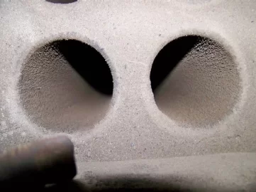

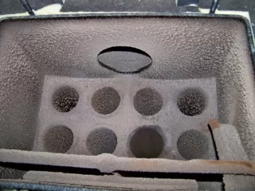

Any thoughts on cleaning hx on Tarm Solo 40 ..manual says every two weeks or so..other threads have said after flue temps start rising over 600 with boiler operating normally in all other respects....I have been running for about a month and have now cleaned twice....just had to see what the hx tubes were looking like they seemed good to me ...just fly ash ..I hope to post pictures before and after and wonder if anyone can comment on them...is it better to just clean every two weeks....or wait until flue temps rise beyond normal 400-600..well above 600....Also can anyone comment on the secondary air adjustments...manual has drawings but they are not very good...what should gasification flame look like, as to length.....or is it just go by the white blue color of the flame in the lower chamber...if I have flame dragons ...does that mean it needs adjusting to shorten the length of the flame showing in the lower channel? Any help appreciated... hope these pictures work....

I go by the flue temp....my boiler typically runs around 400 when the heat exchangers are clean.

I have been cleaning mine about once a month, My HX look just like your photos do.I also watch my stack temps but about once a month seems to work for me
I watch flue temp, and during this really cold season here in MN when I'm burning every day, I just clean every two weeks. There is added burn efficiency from cleaning, and it only takes about 10 minutes. As to the chimney itself, last season (first season) I inspected several times, and no cleaning needed during the whole season. I cleaned it this past summer, and not much then, except a little up at the chimney cap. This season, started burning in Sept, checked the chimney about Dec 1, and except for a little fly ash, it was really clean. Probably will check it again about Feb 1, just to be safe. No reason to have and don't expect any issues.
so that's what it looks like. You look like your getting a real clean burn. My first fire was 10/31/08. my stack temps are close to 600 now. guess its time to clean out my tubes. sweetheat

It would be truely sweet if my Solo looked like those pictures. Sunday, gotta do it.

First thanks for post on cleaning the Tarm. Decided not to come home at lunch. Tarm was out at 5 PM, house merely 55. Just ran the bruch up and down 3 times each tube. A little darker than the picture but no creosote (Duh but). Dust like. Still have a bumpy surface and I did not take the time to see if that would scrape off with a screwdriver. It is +4, a swing of 33 degrees. I am happy.
