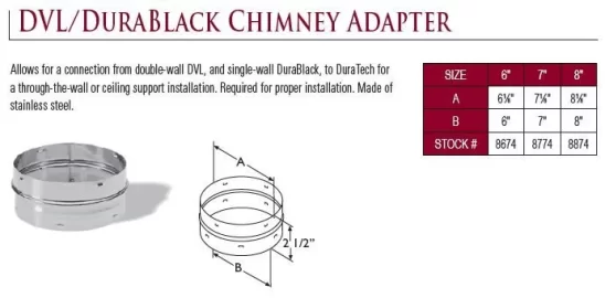

Daksy is correct. It is double-wall all the way, even though it's a telescopic pipe.
You will need the support box adapter. Here's Simpson's instructions for the support box:
"In order to join this type of connector to the Support Box or Finishing Collar, a DVL/DuraBlack Chimney Adapter is required. The DVL/DuraBlack Chimney Adapter slips into the opening in the Support Box or Finishing Collar."
Assuming the T4 flue collar is like the T6, there shouldn't be any need for an adapter at the stove end. The inner liner and outer sleeve of the DVL pipe fit the flue collar like a glove.
