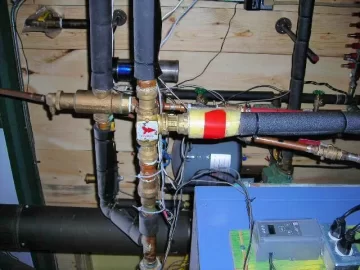

SteveJ said:Mole,
Do you have a pic of the termovar install?
Is your circulator on supply or return?

SteveJ said:Jim,
Thanks for the picture and the orientation drawing.
One question, my termovar did not come with the unions- can you attach directly to female NPT pipe fittings?
