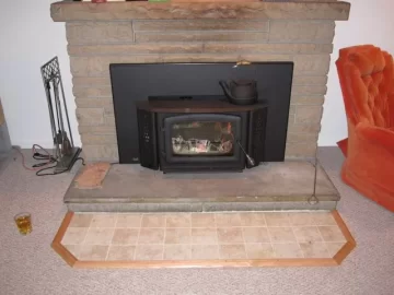

Here is a pic of my Kodiak. I did the install myself in a few hours. The tile hearth extension took another couple days. It's a great insert. If you have any specific questions, let me know.
