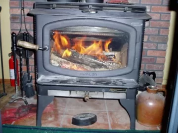

It's official........we're burning again!!
-Soupy1957

Not here, at 60F no fire today.

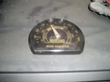

That top is hot. Is the blower running?
the stove always runs at that temp when dampered out an inch or so on the rod............the flue temp is right where I like it (and maybe even a tad lower..........usually I run it TDC).
No blower on the stove........fan to the furnace after a bit.
-Soupy1957
At that temp I'd have a blower running.
I turned on the furnace fan................there..........that make ya feel better? (lol)
By the way, the black thermometer is mounted on the flange that overhangs the face........it's not on the "top" of the stove.
-Soupy1957
Nope. Furnace fan would make no difference. If accurate, that is hot for a stove top.
Well, all I can say is that the temps shown are only as good as the thermometer. I can't say that the Rutland is correct. Over the past 3 years of burning I've had no troubles with the stove; nothing glows "cherry" and all has been well so far.

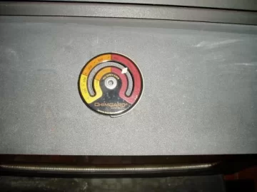

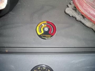

This is interesting.............
I took the other magnetic thermometer I had on the kitchen wood cook stove, (not in use) and put it on the "top" of the wood stove in the living room.......
Note the results. Conclusion? I dunno......,perhaps the face temp is hotter than the stove top? Or that the Rutland or the other thermometer is incorrect?
-Soupy1957

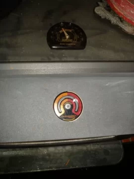

Try them both in the same spot for both areas and compare accuracies.
+1, not surprising, the upper stage is ventilated with the convection space. The lower spot is directly on the stove top. Reverse their locations.
Ok, I'll try that..................back in a bit.......
-Soupy1957
Ok............
Conclusions:
A) The Rutland may be accurate (?)
B) The Stove "top" is cooler than the front flange over the face of the stove
C) If the stove "top" temp is more moderate, no matter which thermometer was used,
it may be said that the stove top is not "too" hot???
Any other conclusions I'm missing????
-Soupy1957

The stove top is what you are calling the flange. The convective top is not the stove top, it has a convective air gap underneath it.
The Rutland may be overstating things, so I would find the laser thermometer. If the actual temperature is closer to 650F you are fine.

If memory serves, last year, when using the IR, (new toy, just bought at that time), I noted that typically the top of the stove was not registering as high a temp as the door glass or flange overhanging the front.
Since both the Rutland and the other magnetic thermometer seem to register temps that are "in the orange" range of the one, when placed on the true "top" of the stove, I'd suppose that all is well.
-Soupy1957
Yes. But your true "Stove top" is not the top pf the firebox. It has an air channel underneath it. Which is why you are getting a cooler temp reading. If you could get one of your thermometers in the section where your blower air comes from, that would be a "stove top" reading. Which would prob be closer or possibly higher than the temps you are getting on the front flange.
If that flange is 700* and if you use the same calculations for your top thermometer, like single wall pipe (although different circumstances) and doubled your 350* from the top. You would still be looking at 700* stove top.
Although it wont hurt the stove intermittently, I wouldnt run it that hot all the time. . .
Heed the advice of BG. The actual stove top on your stove will always run cooler because of the blower outlet. I would have the blower on also if it was in fact that Hot.

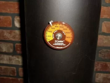

Call me crazy, but I have 3 thermometers on my stove. Two on the stove top (30-NC top is top of firebox) one at the front where the end of the baffle is and another on top by the impingement plate is. The 3rd is a Condar double wall flue thermometer and it is normall just a little below what the actual stove top is. Just a little.

Find the IR gun. Get them both on that lower section and figure out what you are working with here.

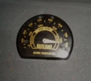

I'd say that's at the top end of where you'd want to run if that's reading appropriately. Just had to ditch my one Rutland as it starting reading low above 450 degrees. About 125 degrees low when it was saying 600.
Also, I could be wrong (I'd have to dig up the emails to be sure) but I swear I remember the Condar engineer I spoke with last year saying there is a different spring used in the chimgards versus the stove top models of the condars which makes up for a difference in being horizontal compared to vertical. I could be wrong, but the IR would help tell that . (Maybe it really only is the paint / scale that is different but if I'm right that chimgard may not read accurately on the stove top)
pen
I do recall, and made myself a mental note, that the flue Thermometer was recommended for replacement every two years, on the manufacturers packaging. I intend to replace it, and the stove thermometers next summer.

The external thermometers should be good for a long, long time. Condar makes no mention of replacing them on a time frame. The probe thermometers do have a lifespan though according to Condar. Not sure why but they do.
