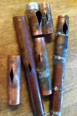

8 breaks altogether .... all OHW baseboard :mad:

Doh! Somebody's gonna be good at sweating pipes before that's over...

I was whooped last night, need to clarify...
Lower level of off set ranch. A section of my lower level, and accessory apartment are on the same zone. Tenant was running wood stove, and I wasn't thinking with my head on straight. T stat did not call for heat, and viola !! By the time I realized, it was to late. Luckily, I was home when they let loose, and are on a slab. I turned off the main, and started mopping.
Pex isn't going to work. We're going with propylene gycol for both zones, and be done with it. Add back flow preventer to stop a potential mix with potable water in the house.
For now, the 13 on the lower level is light use only, and I am heating with the OB for that zone.
