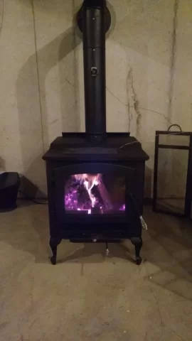

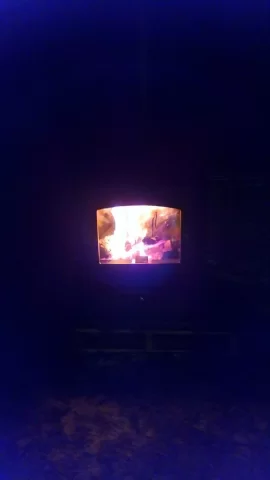

Obligatory pictures to make up for my stupidity. First image is from the hot burn outside and the second is the final install.
Hey wait, in that first pic, I don't think you have the proper hearth requirement of R-value of 1.5 (English units) or equivalent. ;lol;)
Glad ya got that beast in safely.
Now get yourself a good 6inch SS liner installed.:)
I think the 7*F temperatures and 30mph wind that night served to keep that skid plenty cool >>.
