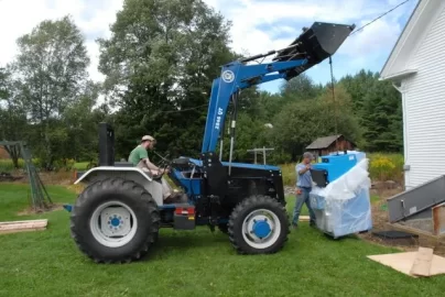

Yesterday afternoon, my Econoburn dealer Jim Crawford brought my Econoburn. With great help from Jim (who's been great to deal with throughout my process of shopping for, choosing and then getting a gasifier boiler), and with a borrowed tractor with large loader, the Econoburn made its way into the cellar of my old farmhouse without a scratch to the house or the boiler.
Hookup is next, but I need to get a couple of other promised projects out of the way before I dive in full tilt on the install of this.
The build quality on the boiler is superb, in both sturdiness and fit and finish.
Thought the photo might be of interest or inspiration to others embarked on or considering a project like this; I'm the bumpkin in the boonie hat.

Congratulations , It must feel good to know the boiler is in the basement in one pc , and can be hooked up even without thermal heat storage for the first winter . That's one heavy boiler
Great job Anthony !!
Cool, Anthony. The boiler almost matches the tractor.
Looking good. I know I sure feel a lot better with the cold nights we've had lately with a wood boiler half installed down in my basement. Now if only I could get some free time to finish the hookup.
Congratulations Trevor, I am anxious to experience the excitement of having my boiler in place so I can start on the install. You are fortunate to have hydraulics to help with the project! Someday I will have to get out to the east coast, your area looks similar to a lot of spots in Wisconsin.

The sizeable tractor w/ loader was a loan from a nearby friend- and it made ALL the difference. All of it wouldn've been a lot less tricky if I'd had a bigger opening into my cellar, and not had a bay window (doesn't quite show up in this photo) so close to/ above the cellar hatch.
My own tractor with loader is about 50 years older and a fraction of the size (1956 JD 420W w/ #35 loader- all orig., but no show/trailer queen), and would not have been up to lifting the amount of steel here...
I put my Tarm in the same way but with a slightly smaller tractor. It didn't quite reach the floor so we had to get the rollers underneath it in order to release the chain. I remember the feeling of getting it up in place. I ran mine for 3 seasons without storage and am looking forward to this season with it. My tank is done now and I just have to adjust one corner of the liner that is pulling down too much. I hope to have it charged by the end of the weekend. Good luck with the install!
