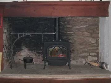

Everyone,
I finally got my Jotul F500 Oslo installed yesterday. So far, I am really liking the stove. It is heating well and I really like the way it looks. I do have some questions for the experts as this is my first wood burning stove. Sorry for the beginner questions.
1. I have a thermostat on the unit, placed on the top of it. How hot should, or can, I get this? I did the break in burns, so the top heat so far has been about 400. I guess I am not sure how hot I can attempt to get this thing.
2. I saw in the manual that I should never run the stove with the ash tray open, however I get a REALLY strong burn when I open it. It is like a jet engine. My question is, can I open it for a few min when I am starting a new fire?
3. How tight can I pack this thing? I know once I get enough guts, I would like to try to burn overnight. I am not sure how much wood is too much.
4. How low of a temp is too low? Is there such a thing as too low?
Thanks so much for all your help so far on this project. I included a picture of what it looks like installed. Thanks again!

Congratulations on the new stove. It's a great heater. Lots of folks are burning in them here. Only problem I see is that the fireplace is too small ( :) j/k)
The stove will run about 500+ on the stove top, but it's ok to run it hotter up to 700F if need be. It can be filled pretty full, but leave at least a couple inches of space between the top of the wood and the secondary manifol.
Is there a block off plate at the lintel level to stop the heat from being trapped above the stove? In this type of installation I would also consider getting the optional blower to get more heat out of it.
Thanks! Yes, the top is sealed off so I should not lose heat up the fireplace. It is 8.5 feet wide, so that was a major concern.
I actually did order a blower for it for the exact reason you mentioned, it will be installed next week. Glad to hear you think it might be needed as well, I was wondering if I wasted my money on it.
Wow, 500-700F. Ok, good to know. I guess as it gets colder out, I will start to crank it up. As I write this, the stove is at about 375-400 and the room is getting up to close to 75F. I cant imagine what it would be like at 600F+!

I want that fireplace!
Yes, it would be great for testing. Looks like you could put 3 stoves in there.
Perfect for using just the right stove for the seasons. I could stair step them. 30-NC, F3, F100.

Howdy neighbor! Nice fireplace! I have one of those, but a little smaller (fireplace, not the stove). How old is the house?
Hey, we are right down the street from each other, I am in Chalfont. Small world, huh? The original house was build in 1740 with add-on's in 1760, 1800, and 2000.
Ha, you beat my by a year! The original portion of our home was built in 1741 with an add on in the early 1800s. The summer kitchen was redone and attached to the main part of the house in the late 1980s.

Looks like room for a smoker in that firebox. Thanks for the pic, it is massive. I can't even imagine the amount of work it took to tend that fire back in the day. Amazing what time and technology has done for us. Who knows, in a hundred years, there will probably be a stove the size of a tuna can putting out 75,000 btu's, vented through a 1/2 pipe... with overnight burns.
There's a Blaze King joke in there somewhere...
