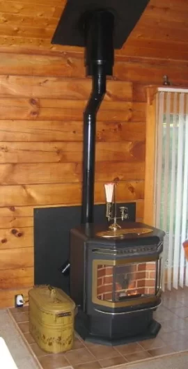

CDodge,
yes, you can go into a wood stove flue. I did it with my install. I went from a 4" pellet stove into the 8" wood stove pipe. Here's a pic, and if you have any other questions, PM me.

Beautiful set up Mr. Macman. I'm glad to see that it can be done with ease. I am leaning more and more toward a pellet stove. Just gotta convince the woman of the house!
