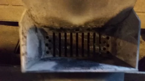

i drilled extra holes in my pelpro burn pot, it has slots along the bottom but they stop 3/4" from both ends and i was having a problem of ash buildup in the corners. Once i drilled 5 .125 holes in sorta a pyramid shape it burns great now and no buildup.
Reactions: elevenMracing
Heres a pic

IMO, extra holes don't hurt and most times help so long as you don't get carried away.....
