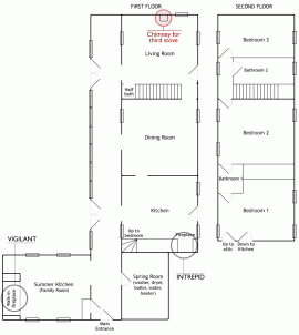

With my ongoing struggles with the Intrepid I am putting serious thought into cutting the crap and buying a new stove and putting it into the Living Room (floor plan is attached).
Here is my list of stoves I am looking at:

What scale is that drawing? Is the house open to the "spring room"? I have sold the Heritage and the Pheonix over the years. Folks like em both. Always happy. The Heritage has the side loading feature which would make it a hands down winner for me. It also "appears" to be the right size for your house.
House is about 2150 square feet farmhouse built in 1741. Kitchen, dining room, bedroom 1, and bedroom 2 have stone walls. Drafty, but slowly getting it under control. Spring room is not open to the house, door is kept close. It contains the furnace, washer, dryer, well pump tank, water tank.
That's a tough layout for wood stove heating, I can see why you need 3 stoves. Maybe a wood furnace would be better?
Your the guy with 2 stoves right. I remember now. I would say you would be THRILLED with the Heritage. Do it within the next couple of weeks. Hearthstone is having a 10% off sale. In fact, go buy it today so you can claim the rebate on your 2010 taxes and get your cheese back faster. Go go go hurry!

Well, it's more like 1.5 stoves with the way the Intrepid is performing.
What about the Phoenix and the Mansfield? Specifically the Phoenix. It is a bit bigger. What type of difference will I see/feel?
I thought about the Englander add-on furnace, but I have base board heating and no duct work.
