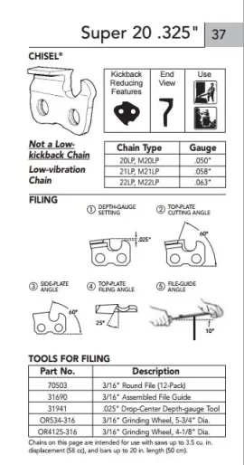

Oregon has a similar manual. Which also have all details about each type of chain in their program, like different angles, recommended file diameter etc
http://www.oregonproducts.com/pro/pdf/maintenance_manual/ms_manual.pdf
Not as nice and colorful as Stihls thought, because it is an pdf of the paper version
Oregon have the rest of detail instructions on this site..
(broken link removed to http://www.oregonproducts.com/pro/service/technical_safety_info.htm)
