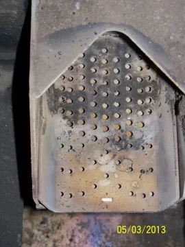

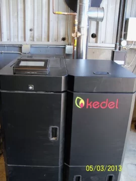

Now that the Kedel is working and I've had some experience with it, I thought I'd update this.
I've had less problems with the Kedel than I did with the PB105 right after installation - even though the Kedel is much more complex. The setup issues were resolved quickly and it's been working well. This is one of the smaller Kedels and has an output rating lower than my PB105 but it still cranks out all the heat I'll ever need. It's rated at 54,000 BTU/hr which, with 8250 BTU/lb pellets, would be about 4 bags per day when it's operating at 100%. They make several different sizes if you somehow need more than that - but very few houses should.
I think my favorite feature is the self cleaning. The heat exchanger has some metal scrapers that occasionally cycle up and down to automatically clean the surfaces off and it has a little air compressor attached to 4 tubes on the front of the burn pot that cleans it off when it shuts down. After getting the compressor installed, I've never had to clean the burn pot again. I really like that. I've attached a little picture of the burn pot. This is after burning over a ton of pellets without me touching the burn pot in any way. There's also a picture of the installation. Also, it's online and can be seen at stokercloud.dk/dev/217.html but it's turned off right now so there's not much to see.
Overall, I wouldn't hesitate to buy one of these if I was looking for a boiler for my house. If I was planning to use it for DHW too (which I already do with my PB105) I would definitely prefer one of these Kedels because it has the ability to scale down to heat domestic hot water and remain efficient.
