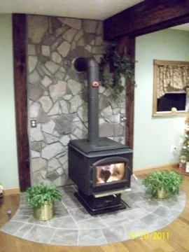

That looks fantastic xclimber...I love it and I am jealous!...someday, I will have one in my kitchen....we actually built our hearth to accomodate that Esse when we remodeled....be bought a Napoleon 1900p, which we love, to go there till we see how good the NZ3000 heats our house, which I think it will do very well....as soon as that is determined, we're going for the Esse.....here's a pic of our hearth.....

Thanks. You did a beautiful job on your hearth. Nice work!
