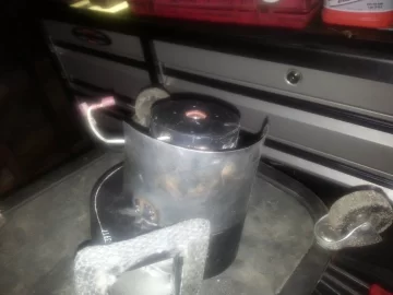

TAS, also referred to as Tim Allen Syndrom, is the inability to allow mechanical components to work as designed. Also accounts for the "modification" of said components to make them better, faster etc.
I had an attack of TAS just a short while ago.

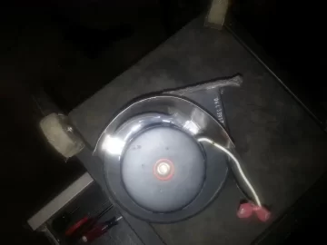

Earlier I posted an issue with a convection blower ( Mike Holton came to the rescue quickly!)
But I started thinking of what may have caused this failure. I noticed that the little motor lives in a hot,harsh environment.
So I decided to make a heat shield to see if this helps. Here are some pics. [Hearth.com] To those suffering from TAS![Hearth.com] To those suffering from TAS!
You might want to see what is next to the blower shell where the motor shaft goes through, on a very large number of blowers there is a cooling fan.
You never want to place anything near that area (and remember that area when cleaning dust bunnies and stuff in there causes all kinds of problems) as it will interfere with the airflow that cools the blower.

There is a cooling fan, but I left enough clearance for plenty of cool air to get to the motor. The heat soak that the motor was suffering from was the reason I put this heat shield on. I'll be sure to keep everyone up to date on my experiment. If I see elevated winding temps I will cut a few reliefs in the shield to uncover more of the cooling fan.

UPDATE: After installing my heat shield, my convection blower has had consistant low temps. It runs OK and doesn't whistle or howl like it did. Temps are still a touch on the high side due to the already damaged motor, but it is running a lot better than it was!

If it were me, I would have made the heat shield out of expanded metal or heavy hardware cloth. That would protect from heat just like in a foundry while also giving more surface area to dissipate the heat that it was absorbing. Other than that, great idea.

If it had been me I would have done a remote fan in a box with a filter for that effort. Three birds with one fan, cleaner air , cooler fan and possibly quieter.
Believe it or not, this heat shield took less than 1/2 hour to make and maybe $3 in scrap sheet metal!!!!
Thanks for the input everyone, I had a few laughs and some good ideas. The remote mounted blower is a killer idea!
I have one working now but it's not pretty. Basement dweller though. Will bend a box to mount fan and filter next season. Big differance is noise transmitted by fan into stove and less dust is a big plus.
Please send pics if anyone has done a remote mount. It sounds badass!
I was also thinking of placing some kind of heat shield between the firebox and motor in mine to keep the motor cooler. It started to squeal and I got it to quiet down with some lithium grease spray on the shaft end. I am racking my brain to think of what to shield it with that would act as an insulator and not heat up. The combustion motor on these Englanders seem to hold up well as they are about 6 inches from the firebox. The convection motors, however, are closer and seem to overheat the bearings in a lot of peoples stoves.
I was also thinking along the lines of a heat cloth shield for mine. Something to block the heat rather than absorb it as steel would.
