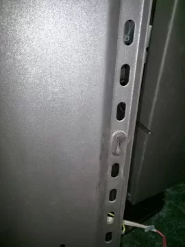

Interesting.. i do have the same issue (shutting off after first burn for about an hour or two). I saw that every time pellets came down the chute, sparks would fly , but i did not notice "whole pellets" flying off. I did look into the burn pot (from above and through the glass while the fire was going) and did see the burning pellets all "exited" moving around with the blowing wind.
I also do not have an OAK in place.. i like the idea of "recycling air" which sort of worked out to clear out all that burned oil smoke from the first burn.. makes me wonder if having that much "freedom" to suck air from within the room is allowing for that huge flow of air.
by the way, anyone care to share the link where you guys explained how to manuf a handle to adjust the damper? I searched for it and ended up in this post, lol.
By design the Serenity moves alot of air through it, try small adjustments at a time closing the air gate, if it still moves to much air then you need to back the exhaust blower voltage down in small increments.I will look to see if I can find my pics of how I extend the air gate out the side. Found them
Thank you!.

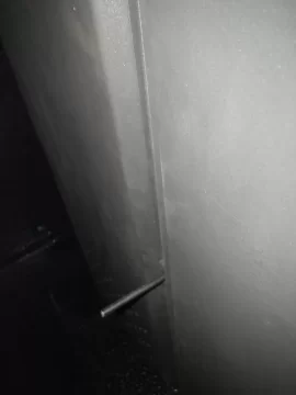

so for the looks of it, facing the appliance is the left side panel the one i need to remove. Regarding the V for the venting fan, i'm a bit hesitant to play with it as my venting consist of 4" pipe (about 4 feet), 3 90 degree elbows and then about 13 ft of 8" Class A pipe going on the side of the house. I would think i need the blowing power to ensure air movement through all of that.
I will try the damper first.. right this moment.

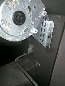

You can easily put the exhaust blower settings back to where they are. I would not hesitate to try blower settings even with your chimney design. You might be surprised how well a warm chimney can pull air upward.
You can access the air inlet gate from either side, but it is easiest from the left when facing the stove.

Thank you Rich, Deezl. I did modify the opening, and it was a PITA trying to open the left side as it was closer to the wall than the right one. Either way, i marked the original position and i might do the soldering of a handle to make it available from outside later on (after this season).
One question tho, does it mean that you leave the screw a bit lose in order to adjust it via the added handle? no concerns about vibration make it vary through time?
