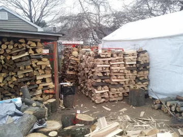

Here's to hoping deep stacks are ok. I am burning a row that was the 4th one back two years ago. Wood is plenty good.
  • [Hearth.com] Too many rows to season well??

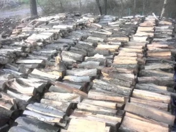

Like you i must stack in cubes with multiple rows. I move the outside rows that get the most sun and wind from each cube and re-stack in the fall under the overhang for that winters use. This gives extra 8-12months time for the inside rows of each stack.
Seems to work for me.
X
