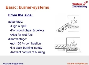

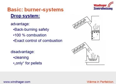

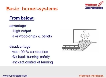

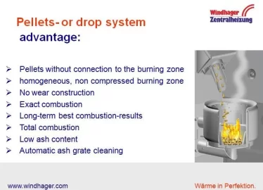

I'm new to the pellet game, but I found these slides when looking around for stuff on my boiler: [Hearth.com] Top or bottom feed which is safer?[Hearth.com] Top or bottom feed which is safer? [Hearth.com] Top or bottom feed which is safer? [Hearth.com] Top or bottom feed which is safer?

My Bixby must be the best burn system in a small form factor by that "advertisement" :) No auger either.
I think it depends on the model as the feeding systems vary even within the two categories.
Interesting slides. my Harman (a bottom feeder) and St. Croix (top feeder) seem to combust pellets the same; I never have incomplete combustion of pellets with either stove. One of them must be defective.
Reactions: F4jock
I get 100% combustion with my Harman. As for hopper fires might improper operation outside of the stove's capabilities be the problem?
Reactions: tjnamtiw
My stove has a drop system similar to the one shown above. The only difference is that the auger angles down instead of up.
I know its promo material, but there must be a kernel of truth in it. Kernel, get it?
Can you provide a pic of your auger? I am curious to how this works. Thanks
Forget what I said. It angles up just like the picture. I dont know why I thought it went the other way. Unless I let the hopper run empty I couldn't take a picture anyways. With the coldest temperatures weve seen in years coming in, I plan on keeping that sucker full.

One glaring mistake in that beautifully prepared sales tool is the 'no burnback protection'. AFAIK all the stoves have snap disks on the feeder and drop chute (if existing) that will shut stove down if a burn back occurs. They're both safe or they wouldn't still be on the market.

My dumb opinion : Bottom feeds look like accidents waiting to happen....who ever came up with that kludge???
Probably because you expect the pile of pellets are just behind that auger - they aren't (or at least not in my Harmon).

Personally, I believe the advertisement is defective.............Sounds to me like an advertisement touting a particular make and not anything based in fact.
EXACTLY. When you get to the last design, it's touted as the absolute best.

I think the bottom feed PDVC has been selling for over 20 years with no problems, and mine works great for me. Will be getting another for basement workshop someday.

I just realized that this company is in pellet boilers and large heating systems, not room heaters. Don't know if that makes a difference on their claims (although the low ash claim on the last one seems to be a bit far-fetched). And, those might all be systems that they provide, not the average system on the market.
The principles of combustion and fuel delivery remain the same no matter how big or small the heat plant is. Case in point, the boiler in my avitar is solid fuel (wood chips) augered in from the bottom (backside) and flyash and clinkers shoveled out the front.
