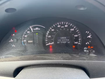

2009 hybrid Toyota Camry with CVT transmission with ABS - Anti-lock Brake system.

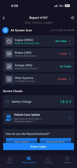

Dumping the code shows C0215
Rear Speed Sensor (LH Circuit)

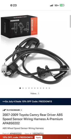

Just a sealed plastic magnetic sensor with 2 pin connectors the stick out the back of the wheel.
They do not go bad often but the connectors can oxidize and the sensor being magnetic can attract the metal dust from brake wear. The inner part of the bearing can rust especially in older cars. All these wearing parts can cause erratic readings which can cause the speedometer and ABS system.
Also, the fact that just removing and even inserting the new plastic sensor can brake the plastic and the magnet, plus the part of the wiring harness that is exposed in the wheel well to the harsh elements can go bad.
So in this case the wheel bearing with installed sensor and wire harness that connects inside the car under the rear seat was replaced.

Pic 01 - Dash lights
Pic 02 - Type of code
Pic 03 - Code
Pic 04 - Speed sensor wire harness

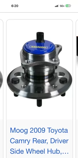

Pic 05 - Rear wheel bearing & speed sensor
Pic 06 - Rear wheel driver’s side speed sensor neck sticks out the back where the wire harness connector plugs in.

I don't have personal experience with this model, but a quick research suggests a possible option is to replace the entire wheel hub assembly, with a new hub already containing new wheel bearing, and a new wheel speed sensor for $40-90 aftermarket, and $560+ for OEM Toyota from a dealer.
If that were the case, i would choose simple replacement of an entire assembly rather than pay someone to rebuild mine, piece by piece if i wasn't comfortable with performing the repair myself.

Thanks bVW - I just had the bearing assembly replaced with the Speed sensor. My mechanic said it is the best way to assure a good fix especially on an older car. :-)
