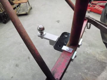

Been wanting to add a trailer hitch to the boom pole on my Massey Ferguson TO35 tractor. I normally leave the boom pole on it all the time unless I need to use the grader blade which is seldom. Should be nice to be able to quickly hook up to my 12' landscape trailer or my bigger 14' flatbed or log splitter as well.
I was in Walmart last night and looked at the class II Reese 81378 Step Bumper Hitch. It looked like it should fit the bill. So after finding a coupon I had for Advance Auto, I pulled the trigger and bought one today while it was snowing. These can be had for around $35 wherever Reese is sold.
I just got it installed a while ago. It was pretty easy, just had to bore 4 1/2" holes to mount the hitch. I had an old 80's model drawtite drawbar laying around that I cut 3/4" off of the end to keep it from bottoming out in the hitch. I used all the hardware that came with the hitch. I would like to add another bracket to the top for more strength but I figure it's got a good bit the way it is. I might do that later. It mounted backwards to the way it would have been on a truck but, if it fits it fits right?

Very nice, you can never have too many hook up connections!
Nice, looks like something you will get plenty of use of!
