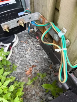

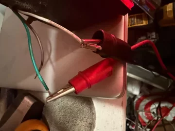

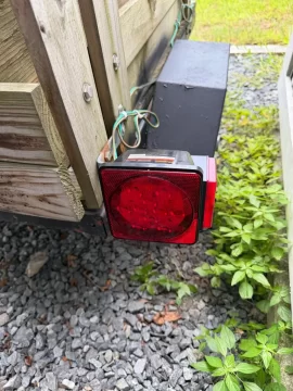

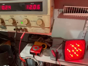

The right turn signal failed on my trailer, it would not blink. All the wire insulated butt connections with heat shrink ends were very good! So I finally traced it down to the 16 guage green trailer wire that goes to the right turn signal, which the stranded copper wire was very brittle and contained a white substance inside the wire jacket! It suffered from sacrificial oxidation, commonly known as “copper rot”!! Budget wire harnesses use untinned copper and porous insulation, allowing capillary action to wick road salt and water! I went crazy and spent $16.99 for a new light assembly and $3.99 for new 10 pack of insulated Butt connectors with heat shrink ends before I found the real issue! I tested the old light assembly still work fine! The harness and lights and connectors were all purchased at Harbor Freight. When I installed the HF wire harness on my trailer I made a big looop of extra wire with a wire tie on it just before the tail light so I had to cut it back a lot when reconnecting it and it worked!!
Also you can see in my pic above that I ran the white ground wire to a black wire with a round connector on it to the trailer frame with a stainless steel screw that fights the rusting. Before I screwed it in, I wire wheeled the chassis to remove all the paint for the very best ground connection.
See bench test pics of old HF Tail Light below

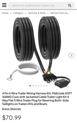

I wish I knew about this jacketed trailer harness?
