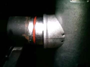

I'm spending my day trying to get my new pellet stove hooked up and I have an issue. I bought simpson duravent pelletpro pipe from dynamite and everything was going very smoothly until now. I have the 4PVP-T3 3 inch increaser T, but it won't go into the back of my stove. The stove is a US Stove 6100 with a 3 inch flue vent straight out of the back. The T has a much larger collar on the outside that I pulled off to expose the stainless inner with the orange o-ring....for the life of me I can't get it on the stove. Anyone have any ideas?
Well I dunno, that thing doesn't look any better than what I have. I consulted with them for several days before I ordered and he put the parts list together on everything that he said I needed. I informed him that my stove was a 3 inch out. Here is a pic of what I have going on. Does the t go on the inside of the stove pipe, or around the outside? I was able to start it going around the outside, but I noticed that it won't be able to slide in there but about a 1/4 inch because of the crimp made in the pipe for the o-ring to sit in.

Well after more research it looks like I do need the appliance adapter....SOB I can't believe he didn't tell me that.....what a waste of a day!!!!!!!!!

that's strange, perhaps it got lost in the talking or something. I ordered my piping from them and Sean was very helpful all the way and he knew what he was talking about, he told me I needed the adapter, so again something happened in the translation I guess.
